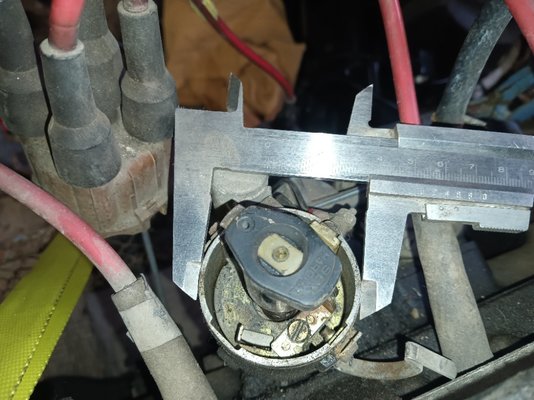

Need help identifying this distributor and its cap and rotor arm 1975 R4
MAT-05
7
czech republic

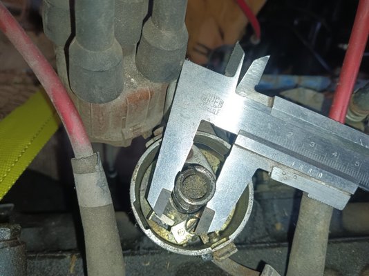

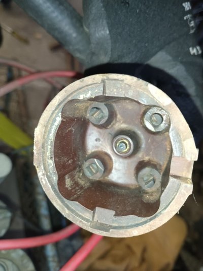

Hello, I want to buy a new cap and rotor arm for this distributor, but I'm having a hard time finding an exact match.
The distributor diameter is 52mm, the rotor shaft is a bit over 15mm.

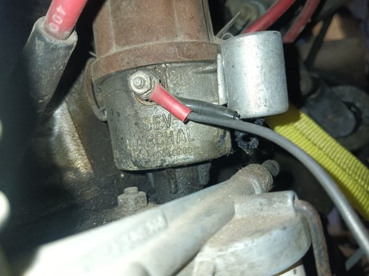

Also, the capacitor has a burned wire, but I'm guessing that any for a 12v system will work.
Thanks in advance
These are the Intermotor numbers for replacement parts for SEV Marchal distributors for the 850cc engine:
Points: 22870
Condenser: 35450
Distributor cap: 44330
Rotor arm: 47210
It should be easy to cross-reference these numbers and find other manufacturers' equivalents.
