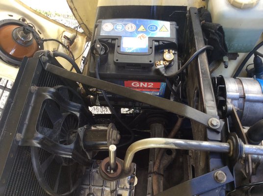

From your description Sepharad it sounds as if you have the two wires that should be connected to the positive terminal ( as mojobaby states,one to alternator, one to starter) connected one to each terminal, both should go to positive terminal and your missing the earth(negative) wire that attatches to front left hand of gearbox,by radiator just under fan.
Thank you for the photo. I was worried I had them reversed somehow. Buyt mine is identical to your phot Laxeian (Andy?) I got brass replacements just like the one in the photo, but with wing nuts. The old slip on claw type werepretty corroded and loose. By fear is, that its something else. I will replace them tomorrow.
