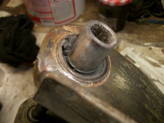

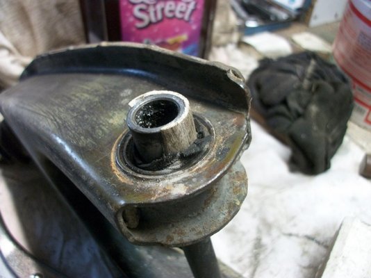

I removed the wishbone suspension and found the bushing to be badly worn.
The inner metal tube is not supposed to move but it came out very easily because the surrounding rubber is worn thin.
Ads a temporary fix I jammed in some plastic conduit. There is now no movement at all in the wheel. The plastic should last a while at least until my parts arrive
