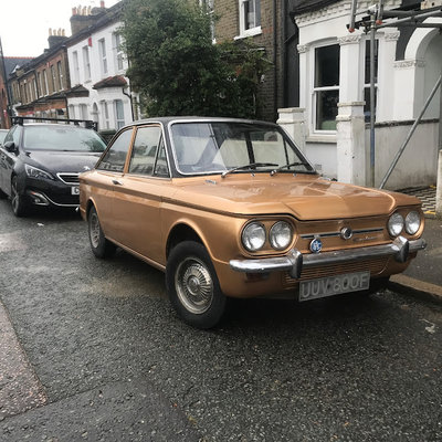

I am now using Super 98 in the UK in my 66 Stiletto. There is some talk the E10 will attack old rubber fuel pipes and even rot solder in the carburetor.
For 10p a more a litre I won't risk it. The car is a bit more refined than an R4,twin strombergs for a start.
(Slightly off topic) Is that a Sunbeam Stiletto, based on the Hillman Imp, but even faster? ~Blimey, they ARE rare! If memory serves, 4 headlights and a more sloped rear window than the Imp. Nice, very nice!
When in France recently. there was the national open day, so we went to look at the local castle. While there a Hillman Imp in the pale green colour turned up, driven from the uK on a touring holiday. Rare even in the UK, but to see it there was amazing.
Yes it's quite quick, or at least feels it!
Main difference to Imp is twin carbs, 4 headlights, fixed rear window, vinyl roof, servo brakes, oil cooler and different instrument layout.
ive just had it fixed up with a lot of new panels and resprayed after 20 years in my possession
