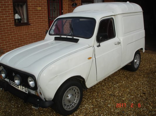

Woo Hoo another MOT passed with the van - this time with NO ADVISORIES and emissions way too low for me! 0.11% CO - I must have a cat fitted on this engine! MOT man reminisces saying the van smells just like the ones he used to service....
