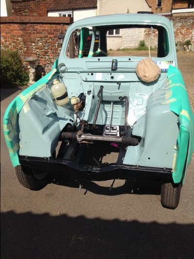

I'm sure you have but just in case.....you've seen the little air bleed pipe coming through the bulkhead above the heater within the engine bay? It has a screw closure on the end and the pipe is about 15mm diameter. Sometimes air locks come out on their own if you open such vent pipes
See in the middle section two big heater hoses and one little one tip centre right
