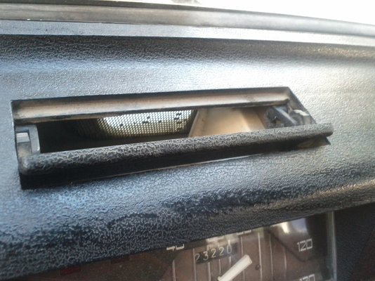

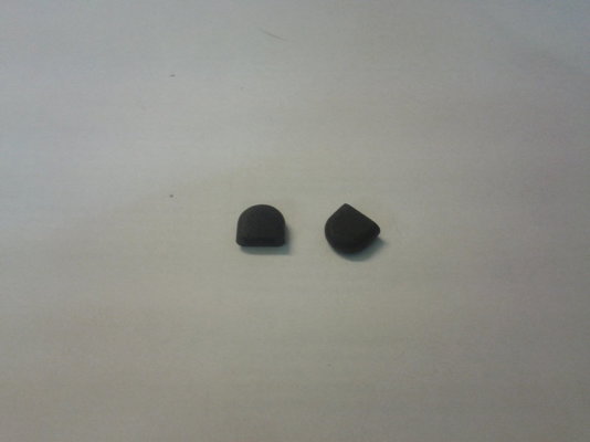

The first part I fabricated is the pair of ratchets that hold the dashboard vent flaps closed or midway opened. Here is the result:

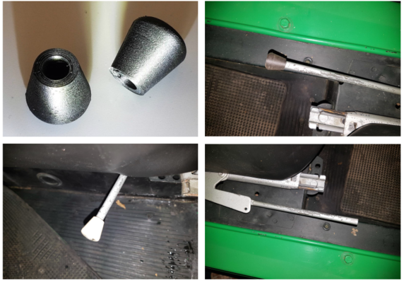

@orsome: I think such handles would be easier to turn than 3D print. Easy to make, though, if you don't care about the matt finish typical to ABS material. To get an idea, here is a first attempt for the finisher ring on the gear shift lever tube:

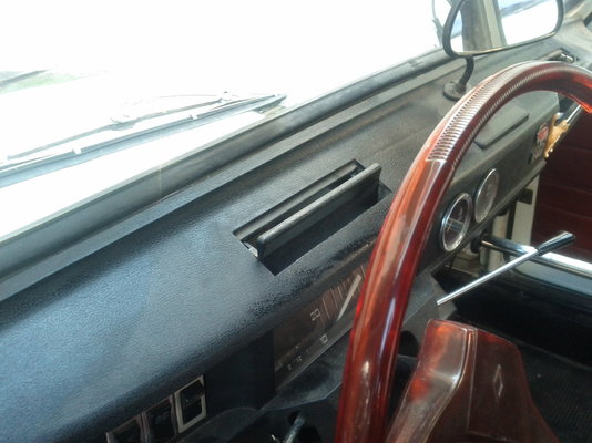

View attachment 29674View attachment 29675View attachment 29676
Angelos-my flap is hinged so to open/close from Bottom..(R2106) -84 would your hinges fit "other way round"? -one of mine drives me crazy as it keeps flipping open/close or just acts as a live spoiler.. -Reid

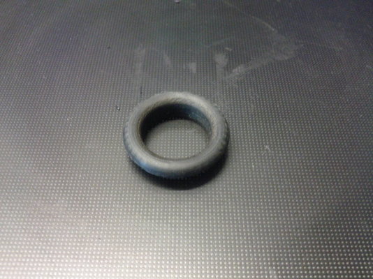

Final version of shift lever tube finisher ring:

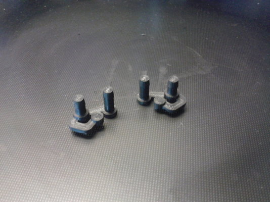

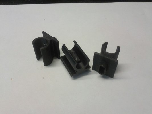

Wheelbrace holding clips:

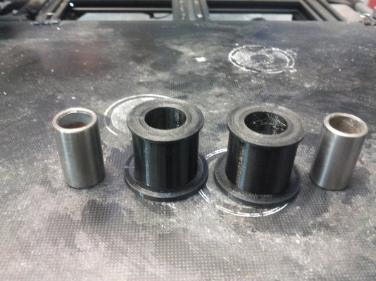

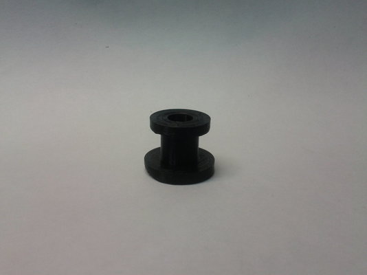

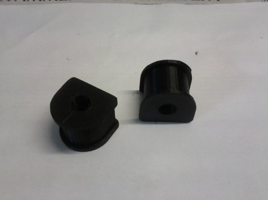

Polyurethane anti-roll bar bushes. I made them in 12mm, 16mm and 17,5mm (5 Alpine Turbo) inner diameters, both with external flanges to hold them better in place, and unflanged. Currently fitted on my cars for durability testing.

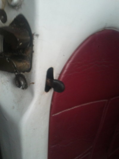

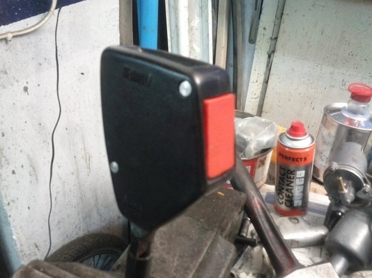

Caps for door lock levers:

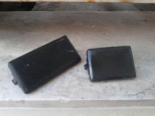

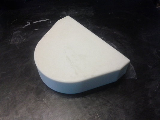

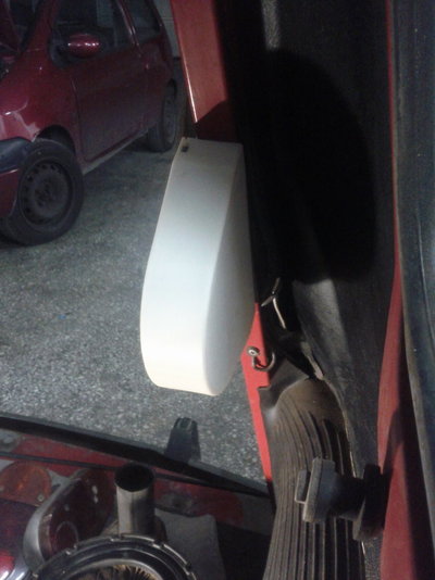

Tailgate prop spring cover. I made it in an off white, as there is no material available in the factory grey-beige. If there is sufficient interest, I'm thinking of making a small batch and spray them in the correct colour.
IMG_20220311_204051.jpgIMG_20220311_204036.jpgIMG_20220311_203720.jpgIMG_20220311_203811.jpg

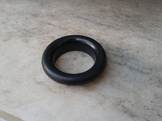

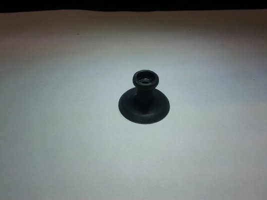

Parcel shelf rubber bobbin - in polyurethane:

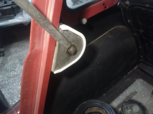

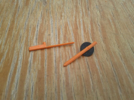

For sunroof equipped cars, part no. 79 03 081 012 / 71 29 998 182. It's the plastic pin for the rubber holding tabs:

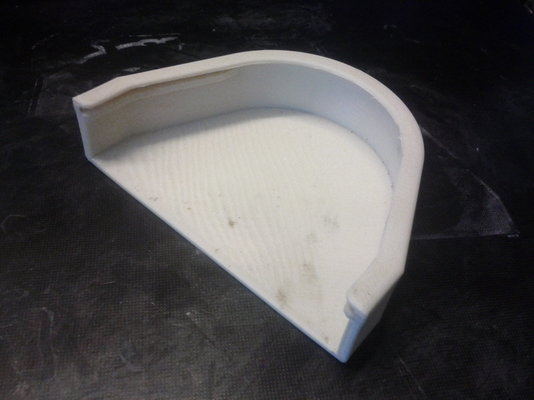

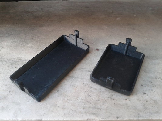

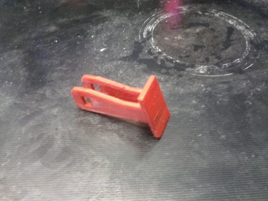

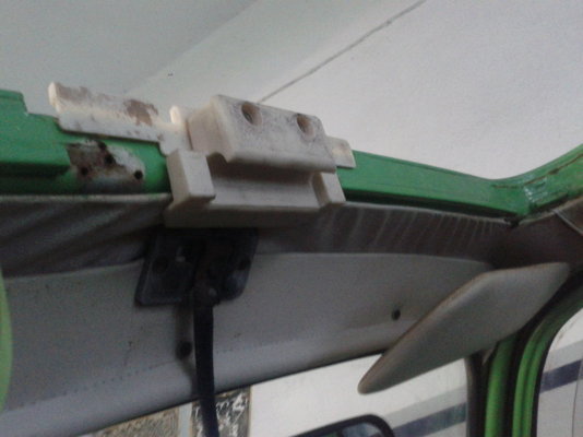

I also made a "beta" version of the body side front part latch. The factory part has two D-shaped extensions either side, to hold the trim around the sunroof opening. On the car I was working it was absent, so I didn't need these.

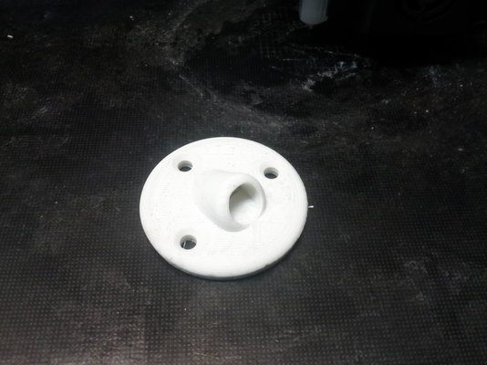

The basic layout of the fragile post-77 sun visor mount.
