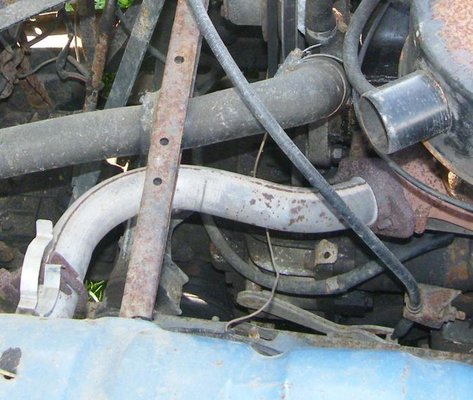

One thing not fixed yet is that the doner R5 have 2 studs on the exhaust-manifold so I can't use the exhaust-clamp from Roffen.
I have not been able to locate correct exhaust-
pipe (going from manifold into front-fender) as aftermarked ones are all too big to fit???? may have to fit make-shift solution at first..
