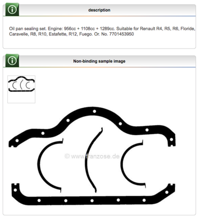

There are 4 gaskets, not 2. You'll have to get some gasket cement or glue to hold them in place while you get the sump into position.

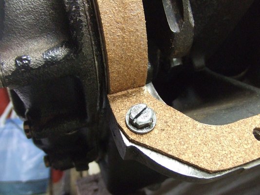

The main thing that you have to worry about is the positioning of the gaskets. At the back of the engine at the timing cover, the overlap of the gaskets should be as per the below photo. The piece of gasket over the front main bearing cap (flywheel side) is the last to go on so the it overlaps the 2 side gaskets. It is the opposite to the back.
I think that perhaps your leak might come from this point where the gaskets join. I also used some gasket silicon sealer at this join.

The gasket setup between 2 types of engine is different mojobay yours is 845
The 956 and 1108 uses 2 rubber half moons with cork over top
Remember that this was car with timing chain problem so the sump will of been 9ff before and probably not refitted correctly

This was the reason of the leak. When I put back the timing chain cover last time I must have misplaced the seal and this is the results after a few thousand kilometers.
