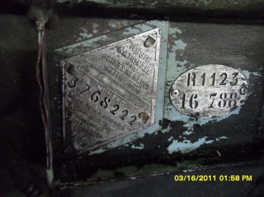

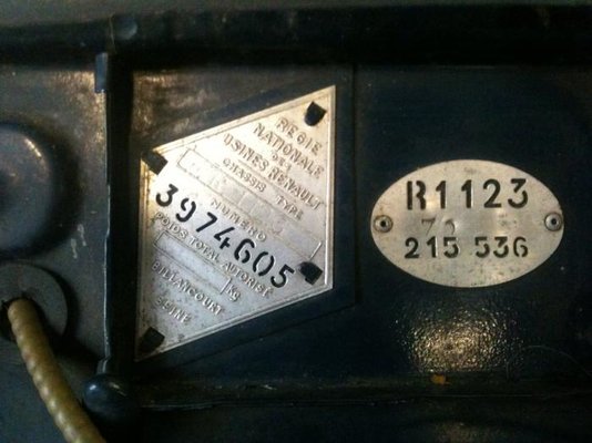

i've got two codes here, wondering where the date of production is,etc,
what does it all mean?
confused Steven

Steven, the first one is 1965, the second one must be 1962 (without equipment code-early!). The key number is the oval plate one, the other is just for registration purposes.
That little "70" on the first oval plate is equipment code according to country of destination (changed later to 3 digit).
Gary, production numbers always refer to model year, that is, July of previous year to June of current year.
Thanks for that Angel. I guess it goes along with year - batch numbers. The first image is off my car, which was sold to the original owner in London and then he shipped it out here to Canberra. So I guess the 70 corresponds to Uk delivery cars?
