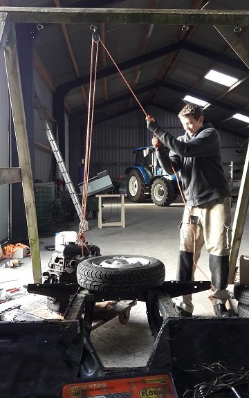

Or build a double A-frame with topbeam from some old wood beams, some rope and some pulleys as I did when my youngest son hoist the engine out back in 2017 when he was 16, a one man job.
