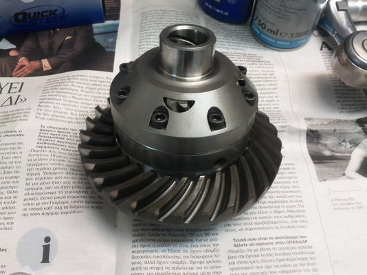

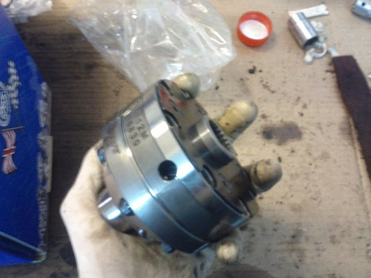

Tiny, it fits in the palm of a hand!

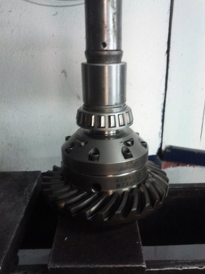

I had already removed the differential of the 5TS gearbox so I fitted the crownwheel on the Quaife.
New differential bearings

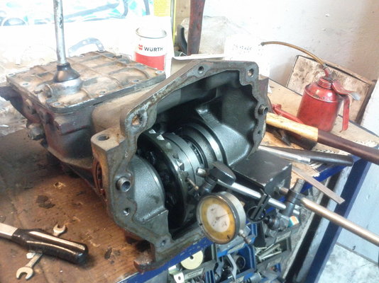

I choosed to follow Gekkoil's suggestion of tightening the differential bearing carriers to the point of zero play, then one notch further in order to set bearing preload. Otherwise i would have to strip the gearbox to remove the secondary shaft / pinion in order to correctly measure differential starting torque.
I then set crownwheel/pinion backlash as per the manual (0,12-0,25mm - I set it to 0,20mm for better lubrication of crownwheel teeth).
The rest was a matter of removing the gearbox of the GTL and fitting its bellhousing and primary shaft to the 5TS one (10mm shorter on the R4), and refitting the unit to the car.

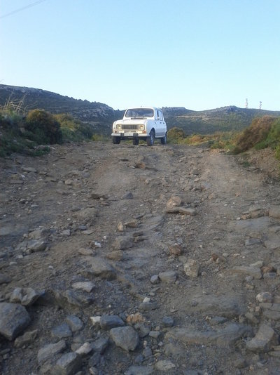

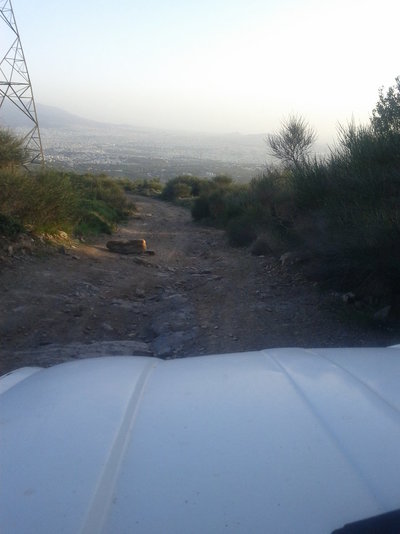

I headed towards Penteli mountain, on an uphill forest road I failed to climb three times in the past. Well this time I almost didn't notice I made it! Road surface was badly eroded from winter's rain and snowfalls, but the GTL never lost traction. Climbing further upwards, there was a very tight hairpin where friends with Cherokees had to shift to low range in order to get past it. It was only then when I felt some wheel spinning, but the car regained traction almost instantly and proceeded. With a conventional differential I would go as far uphill as the tyres (Fedima off road ones) allowed, then a wheel would suddenly break loose and the car would get stuck in the middle of an uphill. Now I simply chose the line and pressed the accelerator. Amazing! There was a point where the engine stalled at the middle of a rutted, steep uphill, probably because fuel in the float chamber foamed from all that sloshing around. I stopped, started the engine again then pulled away like driving on tarmac. Really impressive.
Having done the first testing, I decided to return by taking the same route. What a surprise...I had to check the GPS twich to make sure I was following the correct route, I couldn't believe I had climbed all that stuff!
