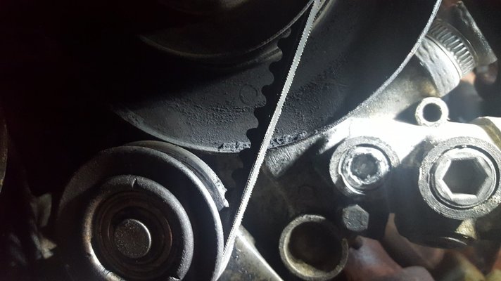

Water pump screw removal also aborted... Someone had been here before me...

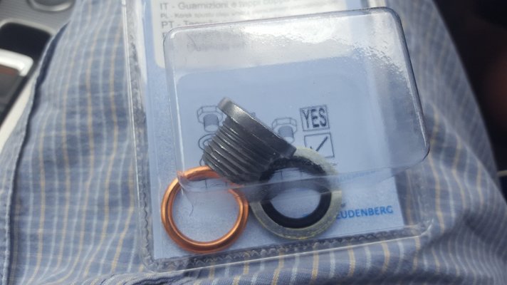

Round 2 tonight.. new sump plug and washer along with hopefully the right filter this time... should have it all oiled up this evening :-)
Question though I have with the new sump plug the copper washer and an alternative metal and rubber washer - verdict - which one to use ?
