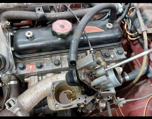

Hi, many thanks for your response. Here’s a photo…
Hi Will
Does it say 'Solex 22-26 DIS' on the top cover? (see arrow - forgive me for copying your photo!)

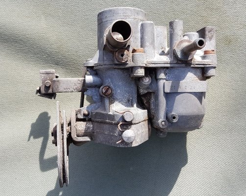

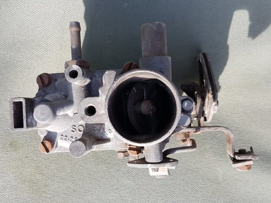

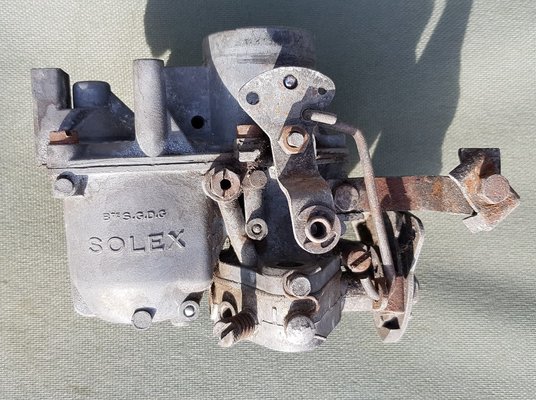

If it is a Solex 22-26 DIS, I've just found this in the garage:
View attachment 32285View attachment 32286View attachment 32287
