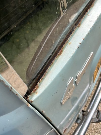

I have a R4 Super with the drop down tailgate which is missing any kind of seal to prevent water running down the window and then into the drop down tailgate.
I have no idea what it should look like let alone where to begin trying to source. I do have the chrome trim strip ( not shown in the photo )..IMG_1362.jpeg If any owner could oblige with a photo of theirs, and of course any tips for sourcing, I would really appreciate.

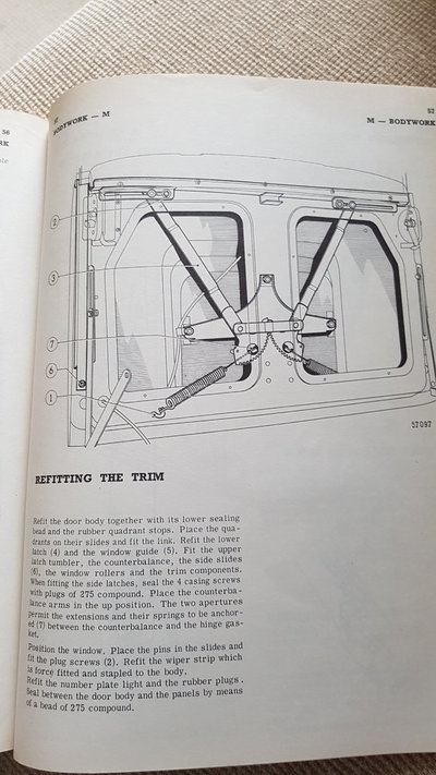

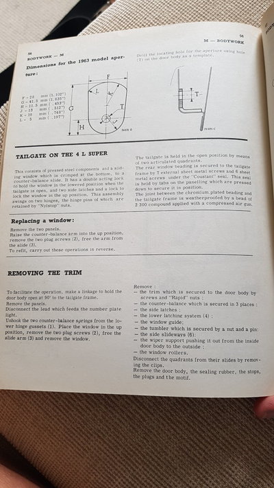

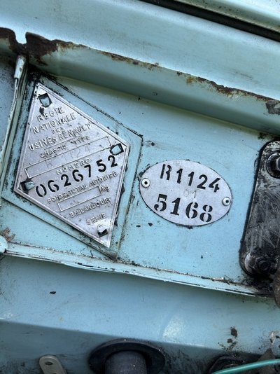

Came across this - would be worth investigating (is yours an R1124?)
These might be a help too:
I don't have any experience with R4 Supers, by the way - please double-check everything!
