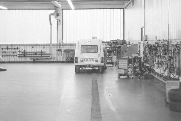

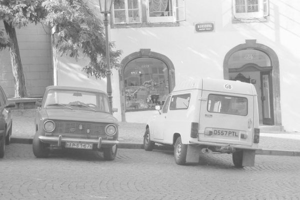

Action Photos including me standing in front of Renault 4 Van, Renault 4 van getting towed off motorway in rain by mad German recovery driver at 80 mph on 6 ft rope and Renault 4 being fixed at German Renault dealership (the mechanics loved it). The points had failed. Van parked in street in Prague Circa 1991.
