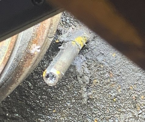

Can’t find timing marks on either the crankshaft pulley nor the flywheel. Can somebody please enlighten me as to what I’m looking for? I need to set the timing.
Are these any help?
IMG_4496.jpegI noticed that when number one and number four are top dead center that the notches in the pulley align with this roll pin. Seems like really a coincidence but may be. Also, is number one on the flywheel end or the crankshaft pulley end?
I have the manual in the link. It shows a pointer about 90° counterclockwise from the roll pin. There is something in that position that might be a pointer, but it doesn’t align with top dead center.

View attachment 33043I noticed that when number one and number four are top dead center that the notches in the pulley align with this roll pin. Seems like really a coincidence but may be. Also, is number one on the flywheel end or the crankshaft pulley end?

So which plug is the #1? is it next to the flywheel or next to the crankshaft pulley? Note that we’ve had the distributor loose and trying to make this run so we can’t depend on that for precise alignment.
Both #1 and #4 are at TDC at the same time. When at TDC the notches on the pulley are about 1/4 turn past the pointer. It appears that it's jumped time about 90 deg retarded which makes sense. We're taking it down to the timing chain but we're stuck trying to figure out how the governor comes off. The housing will separate about 1/8" as well as rotate. What's trick? We could use a service manual if anyone knows where I could snag one.
