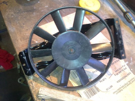

Helo guys I need some help as usual
for the past 9 months Ive been rstoring all my 4l mechanics piece by piece, all the engine and all the other parts,
but now and for the first time I dont know where to start, looks like this one is a disposable part, does anyone ever rebuild one of these?
i have took apart ventilator and bracket but did not opened electromotor.

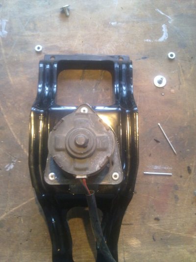

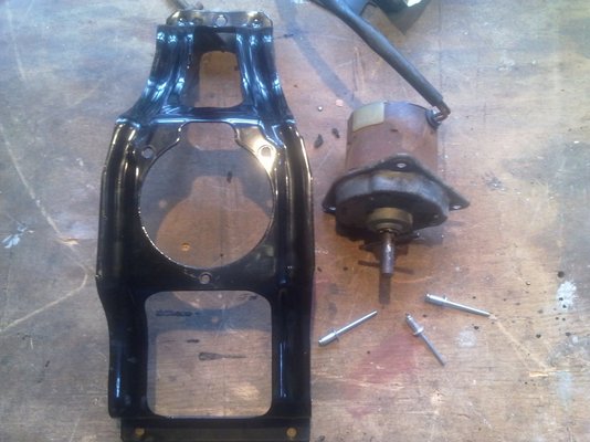

First remove pop rivets from bracket to free it.

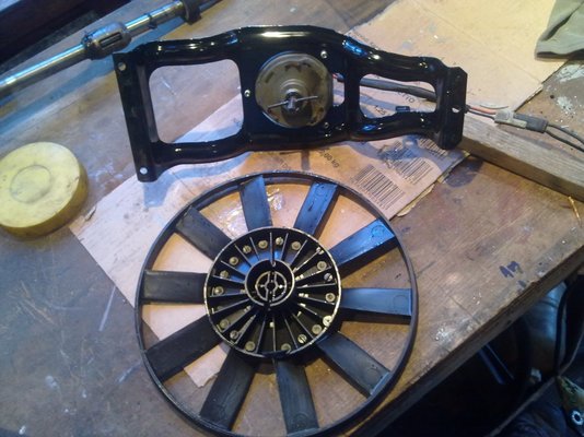

Ventilator.... remove security washer on top of it, and you need to pull it really hard. At least i had to!
Split pin is there to secure motion of the ventilator if start to skid on shaft

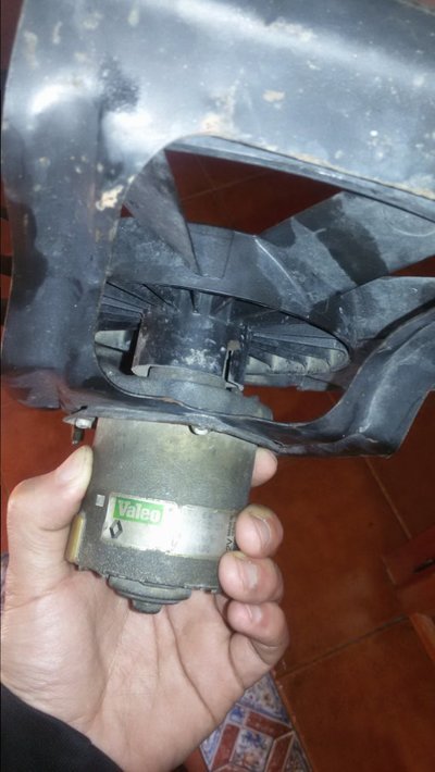

If it is not working you can try to see what is inside. Electromotor is crimped on 4 points but i am afraid if you try to uncrimped it it will brake and it will be hard to put it back together
The electromotor is ok but now is the oportunity to replace the brushes the problem is like you said its crimped so probably to replace the brushes you dont have to open it.
But I dont know if the 2 plastic pieces he as on the sides are the brushes.
Do not know where brushes are located.
