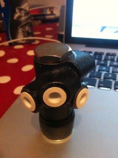

H hal7600 Enthusiast Messages 94 Jul 16, 2011 #1 I got this nice new rear brake regulator from France (only 60 euros). Any clues as to which of the three holes connects to the master cylinder, or does it not matter? IMG_1427.jpg 65.1 KB · Views: 198

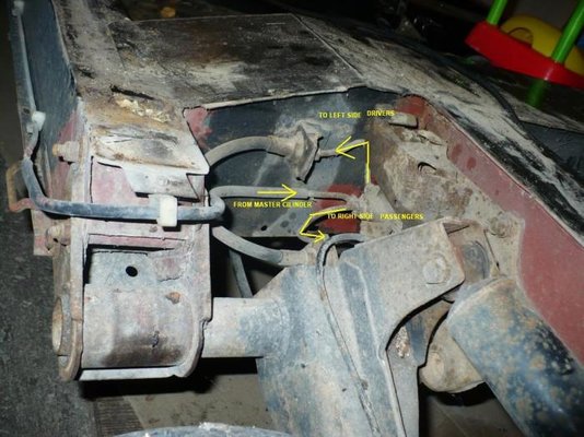

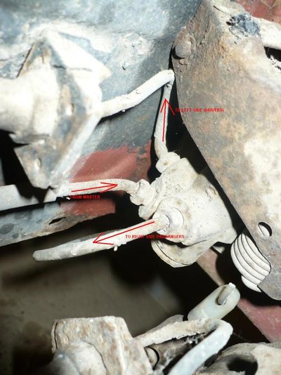

petak Enthusiast Messages 1,906 Location Vodice, Croatia Jul 20, 2011 #2 Pictures will tell more than words. Just take note that it is from 1992 GTL with drivers wheel on left side ( not UK car) P1020773.jpg 64.4 KB · Views: 135 P1020776.jpg 87.5 KB · Views: 138
