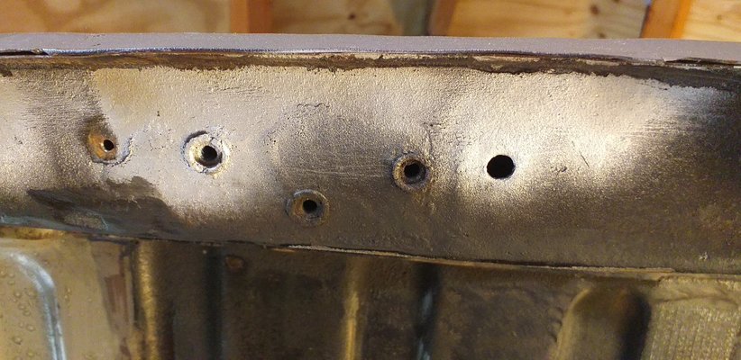

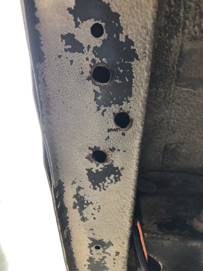

Depending on the year of production.
Option 1
To mount the light under the tailgate the body has blind rivet nuts factory installed, if not just install a blind river nut. This will provide the ground.
Option 2
To mount the light on the tailgate itself, the tailgate will provide the ground.

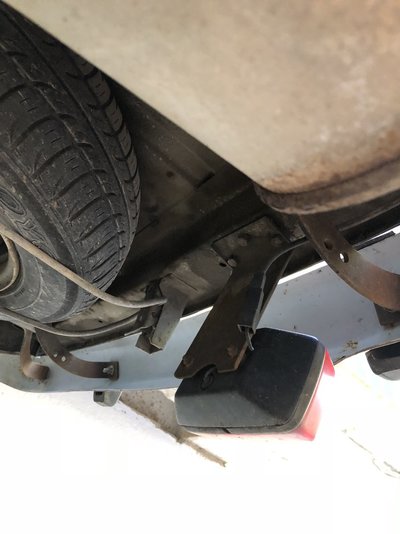

tnx @JdeW , I know where the bracket is mounted..I'm interested in what the factory version looks like (grounding to r4 frame, button connector., etc etc )

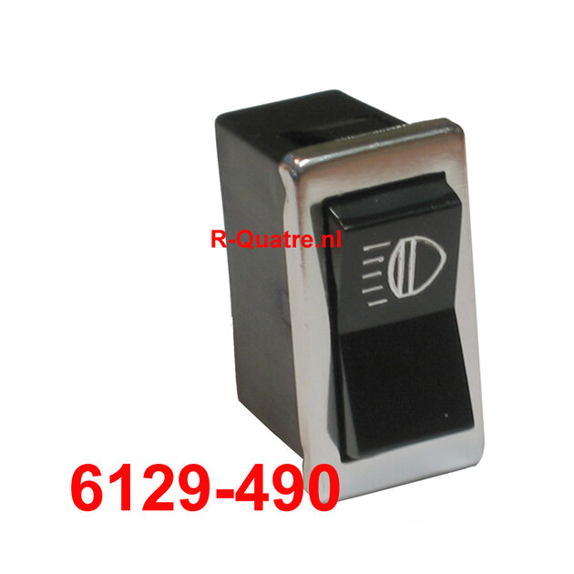

The rear fog light appeared as standard on the Renault 4 Clan and Savane from 1989, on early models is was only an option which nobody took.
The real rearfoglight switch will be hard to find for the third model dashboard but they are available.
7701348744

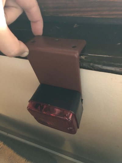

I met on the street.. and take a shot.
Missing ground cable??
my newer r4 is 1989 year..but the previous owner removed it.
