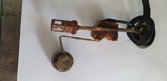

Hello Edwin, Many thanks for this useful information, I have heard good reports about this stuff. I removed the petrol tank yesterday, and the tank is solid although full of fine rust residue and with a little corrosion on the bottom inside. So I did my usual trick and filled the tank up with a strong solution of caustic soda with hot water and left it overnight. I drained it off it this morning, and the tank is like new inside. So I flushed it out with a hose and then my power washer. After it dried I put some Shell Super 98 (No Ethanol crap) and swilled it around and it is now clean a whistle inside. Although I was bit worried about 'flash rusting' so I swilled it around with some 2 stroke petrol inside and left some in the tank as well, until my new sender/fuel pickup unit arrives from De Marco in Italy after Christmas. My original unit was in very bad condition as you can see in the photo. Cheers and have a nice Christmas. Kevin

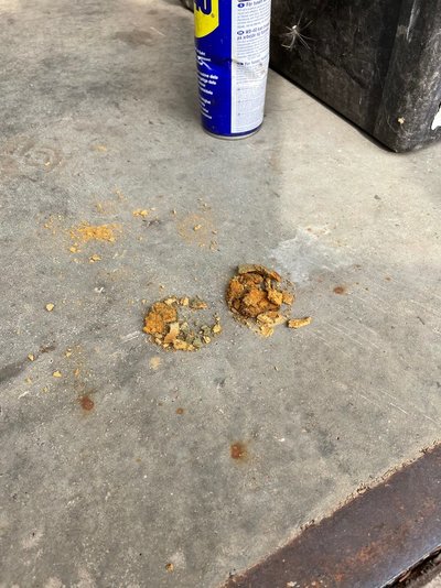

There is two ”problems” with E10 fuel.
First its more hygroscopic than old fuel so if there is low turnaround there will be more and more water in the tank just sitting.
Second the alcohol have a cleaning effect that make all residuals from the “god old fuel” come lose and clog what is downstream.
In the Porsche world lots of people have the same problems, but bigger course they have 80L fuel tanks and most cars only go few hundred kilometers per year then problems become propositionaly bigger. Our Renault have around 25L and I guess mostly get full tank several times a year.
I am front runner going over to E10 fuel here in Sweden. Engine wise 95okt (E10) is sufficient for my std Porsche engines and my Renaults so I stick to it and put really big prefilter or spare in the car
I see the problem the other way around. It’s the old fuel (98okt) that left a lot of residues inside the fuel system and the E10s cleaning effect makes it come off (what we see in the prefilter). Picture below showing what my prefilter collected every 300km two years ago when I started up my 911T that has 80L plastic tank, nowadays it’s almost nothing in the prefilter.
