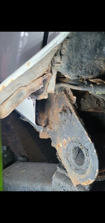

Hi all I can't seem to find these bolts listed anywhere and just wondered if anybody knew the size?
Regards AL

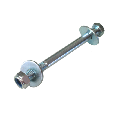

Part number 7703001178 M8x1,25mm lenght 100mm with washers and nyloc nut
But beside replacing the old bolts and nuts, there's way more steel to replace judging by the severe rust (and all the extra inevitably affected area's) on the photo and I know (and many more on this forum) what I'm talking about.

Thanks for the info just what I was looking for and you're absolutely right I've bought the rear outer repair sections ready and looking at fabricating some form of jig next (have seen the info & dimensions on here for that) looked at the existing bolts and thought chances are I'll be cutting those off so just preparations. Need to finish off the upper wing repair before dropping the tank/suspension. Thanks again
