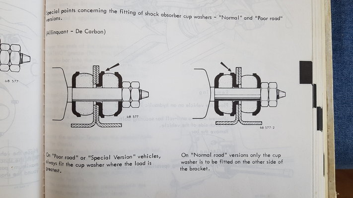

Hi I am about to fir new rear shock absorbers and I need to know the order the bushes and washers are fitted. Each one has come with three metal cupped washers.

These might be useful:View attachment 27944
Dépose et repose des amortisseurs arrière (la4ldesylvie.fr)
Interestingly - and something I've only just noticed - the same diagrams are labelled the other way round in the Haynes manual...
The Autobooks manual for the R6 and la4ldesylvie have the same labelling as the Renault manual in the photo.
That's interesting. I used the Haynes manual as a reference for mine.
The difference must only be very small. Rough road setting for robustness, normal road for comfort. The R4 isn't all that refined anyway and I've not noticed any difference being on the rough road setting. If it's better for durability I will continue to fit dampers that way.
I don't think it will make such a difference, too. Many replacement dampers come with four cup washers anyway.
