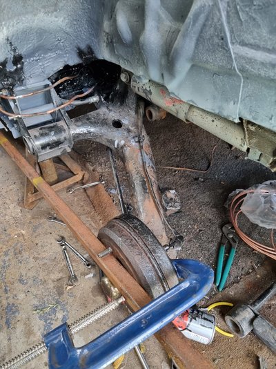

Hi all.. my cars still very much work in progress but was getting the brakes back together earlier (suspensions all been out & re-fitted) when I thought I'd have a quick look at the alignment after reading many threads on here as the hubs seemed to be toe'ing inwards if that's the right term? So I slackened the 3 adjusters and fixed the long box section on in the pic.. yanked it into line best I could. The bar followed the line of the cill mostly but started to run inboard about a foot or so from the front wheel. I know it's not on the ground or the correct way to check but would you think it's roughly what you'd expect. . Just thinking if it needs more investigation I better not rebuild any further.

Excellent thanks never thought to look on there :).. I followed his tutorial for the silent block replacement
