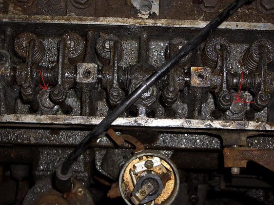

remove of rocker shaft pic two show u wat i mean
is there a special tool two remove the rocker shaft (head bolts) if not how do i do it?
I thought they were just hex nuts - I use a socket set.

You dont need to remove the rocker shaft
Just push the rocker against the spring and carefully turn it 90 degres So it is pointing down or up cant remember which I think one goes one way one the other
Then just use a standard thin type 14mm deep socket 1/2 drive is best

just undo the adjusters enougth to remove the rod then turn the rocker as my previous post
I found this the easiest way on a 747cc engine in my TL
No need to grind, chisel, cut or gas-axe anything to get those two bolts out. It is as suggested by Martin.
1) Remove the tappet adjusting screws for the two blocking rockers.
2) Push each rocker to one side against the spring allowing removal of the pushrods.
3) Push the rocker down, so that the tappet adjusting screw hole is closest to the cylinder head top, this then gives plenty of clearance to access those two bolts.
4) If it is just a head gasket that is being replaced, leave the longest centre head bolt just loose, then knock the head with a wooden block or soft faced hammer gently on the side of the head, this will cause the head to pivot around that bolt. DO NOT lift the head straight up off the block until the head is loose, or you will risk breaking the liner seals at the base of the cylinder liner.

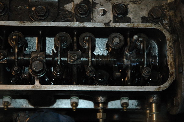

Martins Method in action
I thought some may like to see Matins method in action, it works well.Slaken the tappet,slide across the rocker and remove the push rod, then rotate the rocker as shown,result plenty of access to the two bolts in question.
