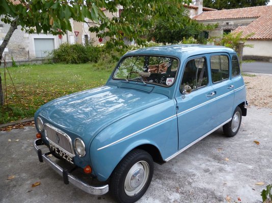

Need a clutch kit and drive shaft pins for PPE 322E. Along with info on the tool for removing Drive shafts.View attachment 15136
Hello! This was my dads car! He bought this new in the 60’s and we sold it around 1995 when he sadly died! I’ve got photos of us having lovely camping trips in the beautiful Renault 4! My dads name was Peter Salisbury so guess he’d be on the registration documents! Wondering where the car is now! Lots of happy memories! Heather
