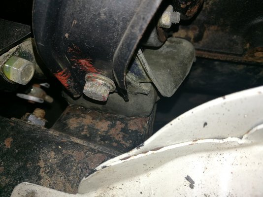

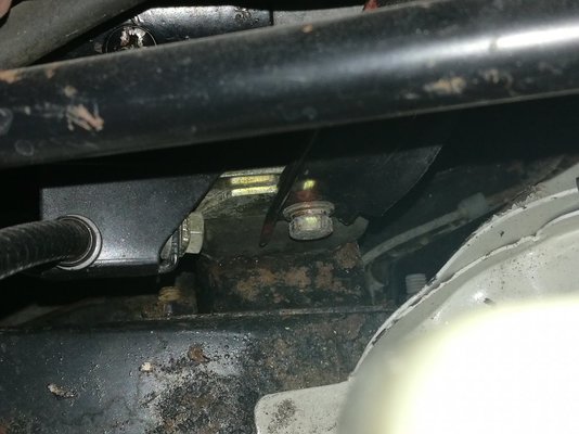

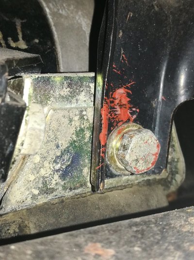

Sometimes it makes these symptoms when the engine support bracket that sits over the starter motor is either loose or missing.
This bracket sits on the left side of the engine over the starter motor and stabilizes the engine from sideways motions.
It looks like a bend piece of steel. Nothing special but it essential for a smooth ride.
Try and locate it just behind the steering axle against te engine over the starter.
Is that support you are talking about? Can you see is everything like it should be? I know it`s very hard to tell anything from the photos, but I don`t have any tool in garage because I am cleaning it right now. Anyway, I tried to move the engine with my hands in side directions, but I didn`t get impression that something is wrong, and there is no any "click" sounds.
Looks all attached id say.
A simple test to check your supports is to put a Jack underneath the engine and try to lift it, put a piece of board under the sump and lift it with a jack. Not to far, a centimeter is enough and it will show a broken support.
