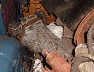

Which gearbox do you have? Is it like the Renault 4 gearbox, or is it the later type in the photograph?
I don't think the differential from the Renault 4 will fit in the gearbox in the photo, but it should be OK in the gearbox that looks like the original Renault 4 gearbox.
The Renault 4 gearbox will fit the Gordini engine.

Gearbox...
Hello;)
I have a later type of gearbox like that on the photograph. The original engine was 845 ccm and now I want to remake it to Alpine, so... I have at home a gearbox from GTL, which fit to the Alpine motor, but... gear ratio is too short and I can`t lead normaly, becouse my first gear is too hight and my car goes 170 km/h in thir gear:(
I was looking for fifth-speed gearbox from an older Renault 5 or R12, but... i was looking vainly in austria, Italy, Hrvatska.... i didn`t find any gearbox the axle of the carriage for Alpine.
