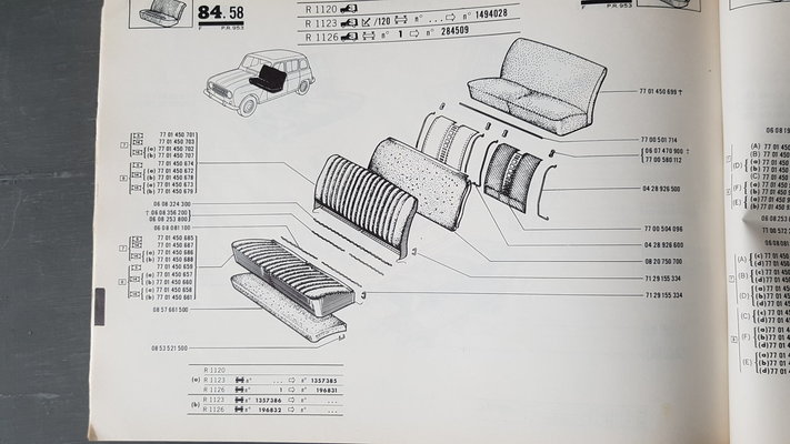

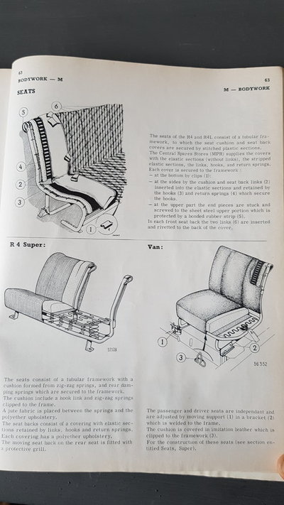

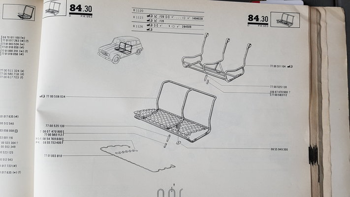

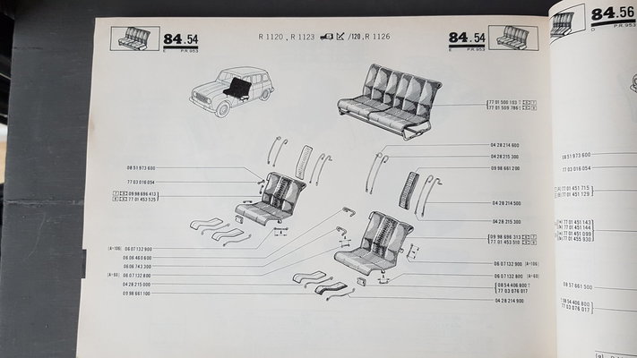

These might help. Does your car have the earlier type bench seat (the first one here), or the later one?20231118_095456.jpg20231118_093557.jpg20231118_094022.jpg20231118_094007.jpg

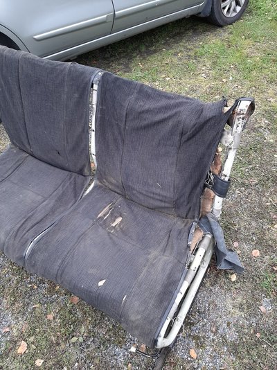

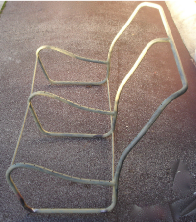

I'll post a picture of my seat, the picture shows what it was like. The second picture is of a Citroen 2cv seat frame, which is almost identical.
This is the seat I have, apparently there are different models.
Be aware that the 2CV frame is some 10cm taller because it is mounted on the floor rather than on a crossmember, as on the R4.
