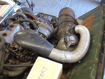

with this cold weather my carb has been icing with an aftermarket filter so I’m after the filter assembly / air box for the Renault 5 alpine.
the car is a Volvo 66 with an early 343 engine - 1400 Renault engine - and the filter looks exactly like those on the alpines
this is what I have:

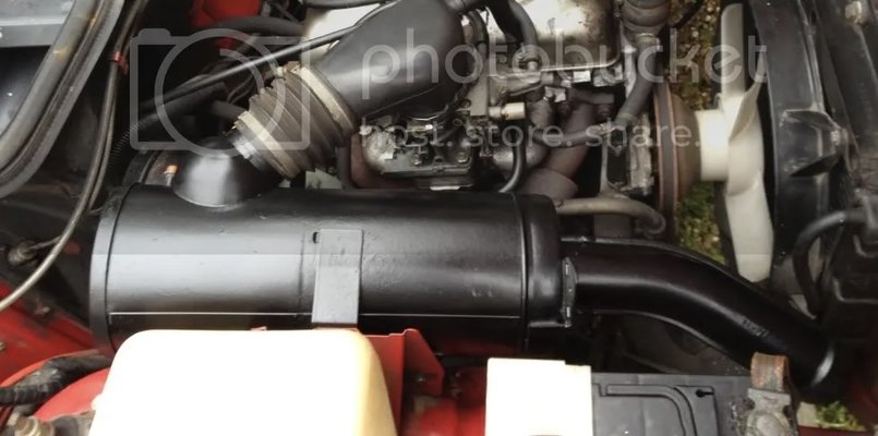

And this is what I’m looking for
anybody got anything?

thats not 5 alpine setupin eirher pic
bottom pic is renault 12 ts and very rare
cant you find volvo 343 setup easier
alternativel make a hot air duct from exhaust manifold to surround the sports setup so it pulls hot air in rather than freezing outside air

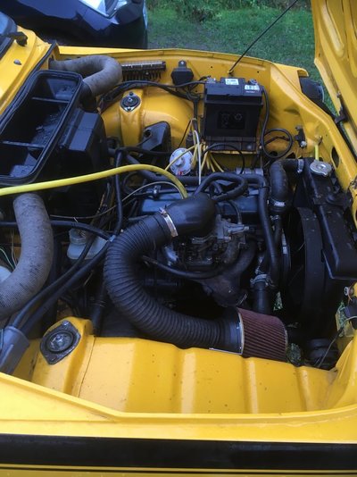

Thanks both,
what filter did Malcolm put in his Gordini here?
for the Volvo I can find the later pancake type, but with only 2 on the road in the UK, none of the earlier type as in the red car above
