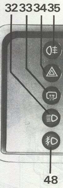

I've attached images of R5 Gordini instrument panel lights. If you can identify the light with the correct symbol, then maybe we can suggest how to fix the problem.
32 Headlamp full beam
33 Heated rear window
34 Hazard warning lamps
35 Rear fog lamp
48 Front Fog lamp

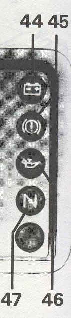

44 Battery Warning
45 Brake warning (and handbrake)
46 Oil pressure warning
47 Choke indicator

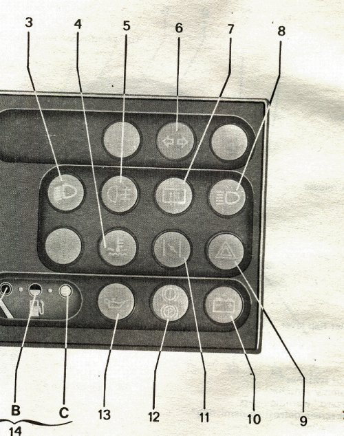

And a few more from the Renault 4:
3 Headlamp dipped beam (normally disabled)
4 Water temperature warning
5 Rear fog lamp
6 Directional indicators
7 Heated rear window
8 Headlamp full beam
9 Hazard warning lights
10 Battery warning light
11 Choke
12 Brake and handbrake warning
13 Oil pressure warning
Thank you, my guess is that the blinking lamp indicates that my brakes are bad. I got some answers from a swedish friend, and he says that not all my lamps are working, because i have the same panel as every Renault 5 after -86.
Well, know I now that the blinking lamps indicates bad brakes. Thanks!
Bad brakes - scary!
That light tends to flash when driving around corners if the brake fluid level is low, or it might flash randomly or when you press the pedal if the front brake pads are worn. Definately one to sort out.
