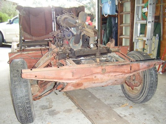

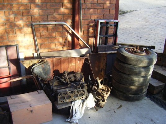

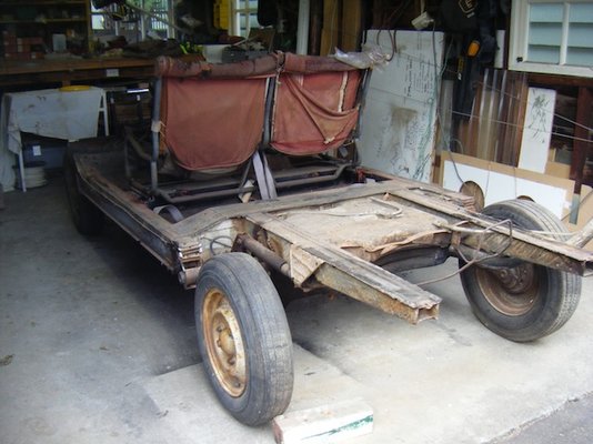

In the meantime, I stripped the chassis. No problems lifting the engine-gearbox out. Only had to disconnect the drive shafts, undo engine mounts and front gearbox mount. Easy peasy.
I was a bit concerned about the torsion bars having read this forum and not having a suitable torsion bar tool. But in actuality was also easy peasy.
'How so?' do I hear someone ask? I took all the bits off except for the lower arm and the carrier that bolts to the chassis. Graeme slipped a pinch bar (aka wrecking bar) in the carrier between the arm and wishbone bolt tube and took the tension of the torsion bar. It was a bit of a push but that much. I'd already undone the bolts holding the carrier to the chassis. Once the tension was taken up the carrier moved freely on the bolts and with a bit of sideways push on the torsion bar the carrier came free of the bolts and we could release the tension fully by rotating the carrier and arm until it went slack. Which wasn't that far.
Granted the body and inner guards were off the chassis; it might not be so easy doing this with them in place. But I'm thinking an 'L' shaped bar with the long arm coming out the wheel well might do as nicely for taking the tension. Could be an easier alternative to make than the special shape to go around the torsion bar mount.

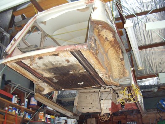

Rear suspension also easy to take off. Again the absence of the body made for easy access. Having removed the shockers, I could simply put a foot on the swing arm to release the torsion bar tension. A dozen bolts and it was all down on the ground.
I have wondered whether the easy of removal simple meant that the torsion bars have become weaker with age. I know I have:(
Here's the rear suspension off and resting on top of the chassis.
