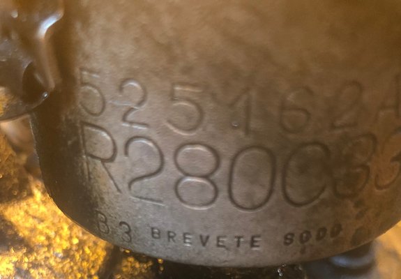

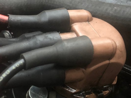

Looking to replace my distributor cap but I’m confused with all the variants. could someone point me in the right direction as to which cap is suitable? I think this one is right but I’m not sure ?
Thanks in advance
E538EEB0-1368-4033-ADE8-EB9F57A695CB.jpeg 1E8EB00C-7C54-4801-8CB1-3E56098CCDC8.jpeg
It looks like your cap is Ducellier 661920 or 662913, the ebay link refers to a different cap.
Strictly speaking the distributor cap you have got fitted was designed for a Renault 5 mark 1 there is an equivalent upright version which is normally fitted to the Renault 4
