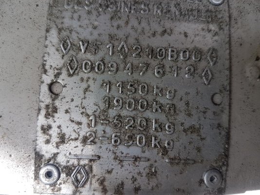

for the mystery f4 please see other post) - 1988 registered 1986 1108, f4 - I think. unsure to hp
I don'tproduction.jpgvin.jpg fully know what car I have>
VIN numbers attached
any helpful info, would be much appreciated. many thanks Damian

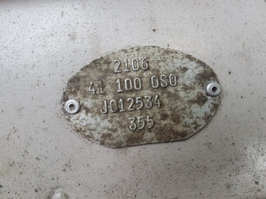

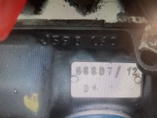

Hi Damian
As your F4 has 2106 as the oval plate number. Your van should have originally had an 845cc engine. The engine number 688 is for the 1108cc engine. It looks like someone has changed the engine at some point. Not a bad thing, as you have more power than the original. I have a used starter motor for the 1108cc engine. If interested email me at: christianebeyer@yahoo.co.uk
