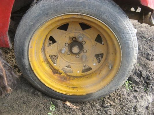

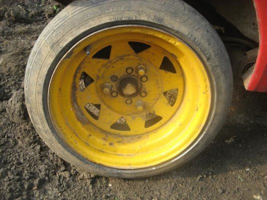

Hello all,
I'm very interested to get this steel wheel ( i suspect that this aren 't alloy).
http://www.flickr.com/photos/46005003@N04/4224393073/
My question is from which car is this wheel? It have 6 holes, and you must make 3 for r4...
Thanks for help, and i wish you heppy new year, a lot's of spending good time with yours r4...
They look like Weller wheels. They are a UK aftermarket wheel supplier, but they've been more into off roading and motor sports (well to my mind anyway), over the last few years. I know for instance that they supply Van Diemen the wheels for their race cars.
They are still in business and their website is here
http://www.wellerwheels.com/
They can make the wheels in any size, PCD and width anyone requires
I think they were Delta Mics (French). They were standard equipment on some JP4 versions, and some Dallas jeep-style.
If you look carefully, you will notice three more holes on the wheel. These are actually for the stud nuts, the six inner holes are to provide clearance for the brake disc fixing bolts, so that nothing like this: http://www.r4-4l.com/forum/viewtopic.php?id=15028 happens.
be aware that renault 4/5/6 have different 3 stud spacing to those that are on renault 8/10/12 /16 and alpine 110/310
also different to r14 / small peugeots / samba
different again to citroen 2cv
have got weller steels on my car so they were available once maybe not now?
