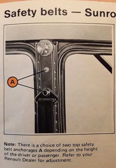

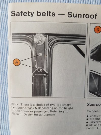

Am I right in thinking that you can move (unbolt) and reposition the seat belt mounting in the door pillar, I noticed two mounting holes, mine was installed on the lower and was pretty uncomfortable, so moved to the upper bolt hole. Is this correct as can't see anything about it in any manual
Don’t forget the plastic shims and the odd springy washer it all goes together a particular way round
