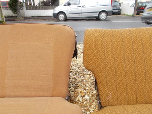

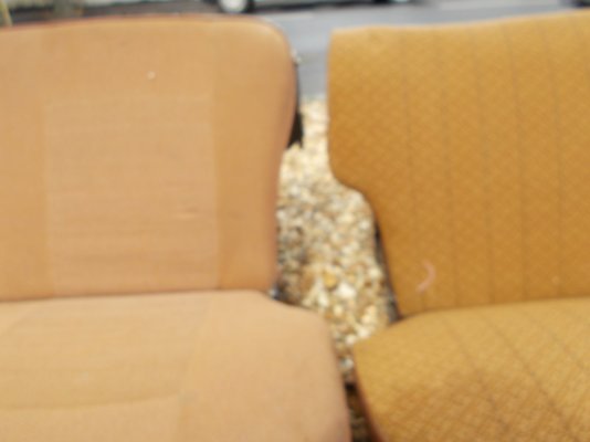

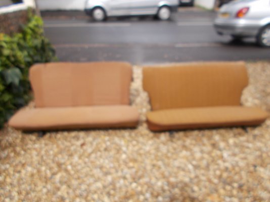

Hello JFM,
I saw your post above. I too have a left hand drive (French) R6TL which is 1977. I also have a 1983 R4 GTL.
As far as I can see, the front seats are identical on both models. However there are slight differences on the rear seats. I have taken a few pictures to help.
As you may be able to see, the shapes of the seat cushion and the seat back curve differently around the rear wheel arches. The pictures are not the best I'm afraid. The R4 seat is on the left as you look at pic.
I hope trhis helps answers your question but it is possible too that the earlier R4 seat covers would fit your rear seat!
