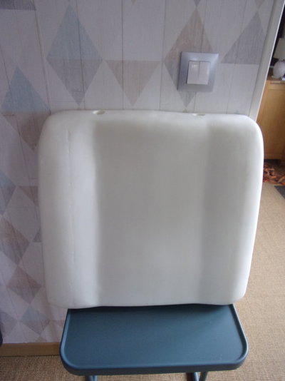

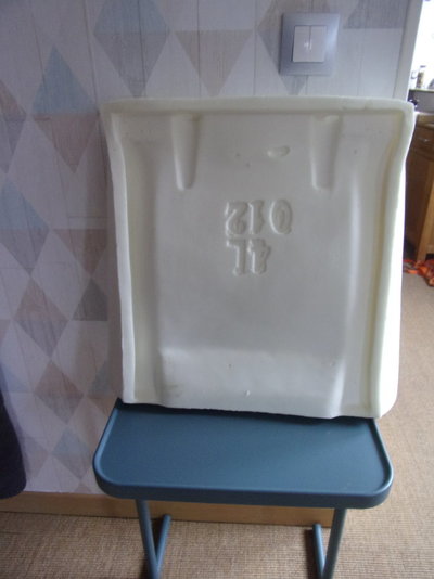

The boss has been complaining about the amount of 'foam dust' under the front seats for a while now, so she had a rummage around on Ebay and found a new supplier of seat foams. We got the front seats out of the car and set about stripping them down. We found that the bases were in excellent condition, but the backs had disintegrated and had indeed already been repaired by the previous owner, an elderly lady who did very neat sewing!
As the supplier of new foam was in a neighbouring department and I had phoned to verify that they were in stock, I decided that an afternoon out was in order and set off to collect them.

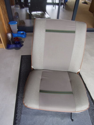

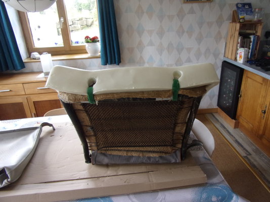

Yesterday was spent wrestling the covers over the new foams and backs of the seats - a couple of kitchen implements, a rolling pin to stop the foam moving downwards, and a flat plastic spatula to help smooth out the sides, were brought into play to ease the job along. It was a bit difficult to work out where the hog rings went to hold it all together in the bottom back part of the seat, so I compromised by using some fairly thin fencing wire to hold it all in place. It took the best part of the day to get them back together, but there wasn't too much swearing involved! Photos attached.
