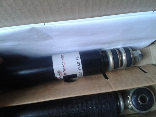

So i got a reply from the rear set and got these guys in the post today.
Down side is that these are comfort and he was selling performance so dunno what to do as I know have the pair,

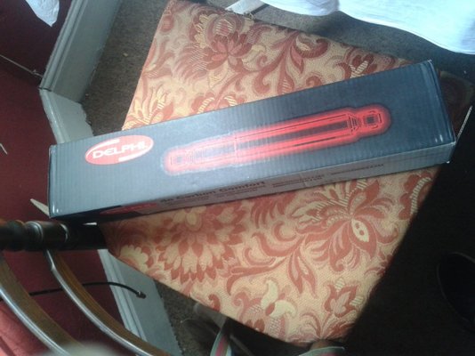

Are these "Comfort" Delphi shocks gas pressurised? Can you see a piece of stiff wire holding them compressed?
They say Gas on the side of the box but no wires =/
