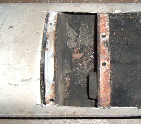

Some of the aftermarket silencers are horrid with the skin wrapped around the baffles and not welded. Plug welds or a good tap with an axe or similar shaped bit of hammer should pull the skin in enough to prevent rattles.

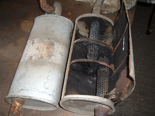

Inside they can be even worse. Here is a Bosal silencer - well made, reasonable gas flow:

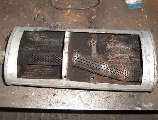

Here is a random aftermarket exhaust made from perf pipe with the ends crimped in the middle chamber! Also no welds to hold the skin to the baffles. It rattled.
I modified mine to make it straight through and stuffed the cavities with glass fibre stuffing. Sounded much better :-) A bit of farting on over-run but performance better for a modified engine and sound levels fine with just a little more character.

Thanks for the silencer photos Malcolm, its actually the first time I've seen inside.
Now I understand why the silencer on my 850 rattles so much. Its the loose baffles:)

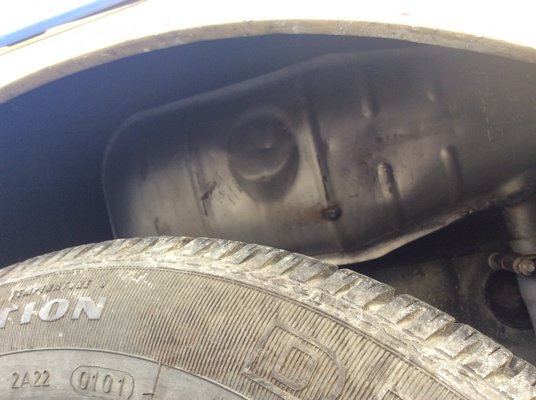

Just a quick follow on, fitted silencer was infact an Imasaf item, so it looks as if I was just unlucky with the one that arrived, fortunatley it didn't require too much modification or tools (4lb club and a tyre lever) to silence the rattle, heres a pic of silencer, the effective blows/dents in this particular case are the ones to the right of the spot/plug weld, the other nicks are just ‘feeler’ blows to locate where a ‘good’ hit would be effective to stop rattle. C3BB71D1-88C4-4A9D-A9B5-31CE94F179A6.jpeg
