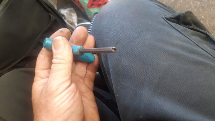

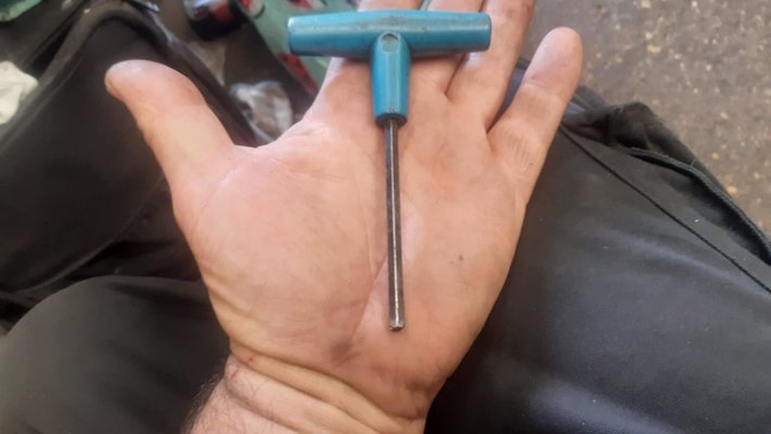

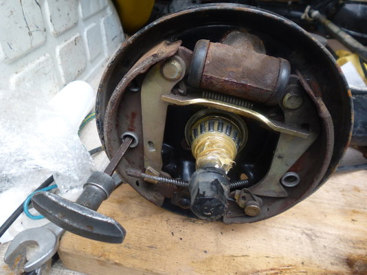

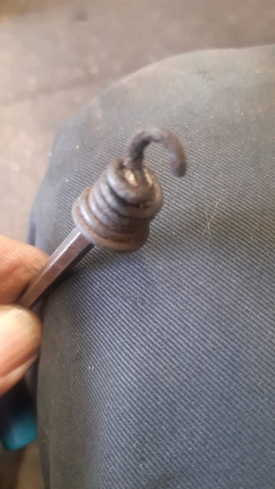

I've got a better one I made from German t handle Allan keyHere's a really simple one - an old doorknob (French, of course..). I find it better than a screwdriver when removing the backplate brake shoe retaining springs!

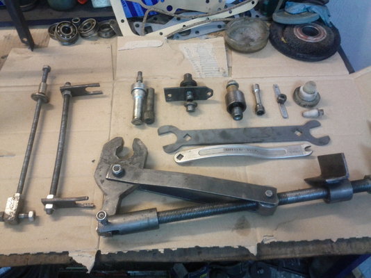

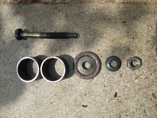

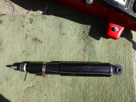

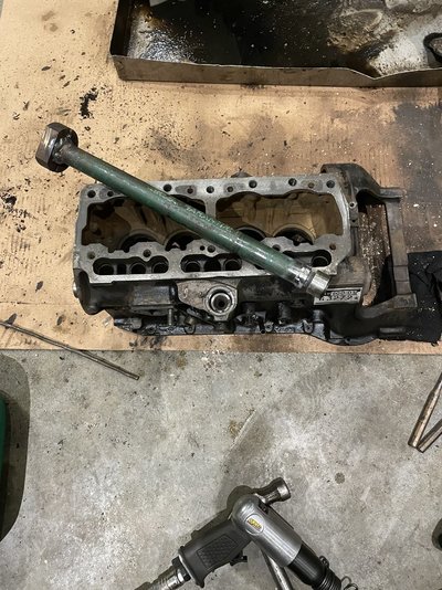

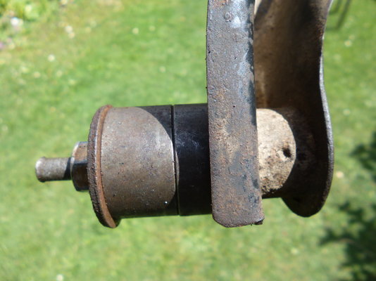

Very impressive @angelView attachment 34673
List of everyday "weapons", left to right:
Rear suspension arm positioning tool
Rear gas damper compressing tool
Set of lower wishbone bush extracting tools
Front drum brake hub extractor
Billancourt distributor bush extractor
Billancourt cylinder head bolt socket
Tool for unscrewing differential bearing carriers
Plug for differential output seals when driveshaft removed (top) / post-79 steering rack boot installer (bottom)
Bottom:
Speedometer worm gear spanner (other end is for the 385 R5 Alpine gearbox)
Brake adjusting tool - commercially available
Front torsion bar anchor lever spanner

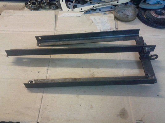

And, on its own, the engine removal/installation hanger.
Yassas Angelos, Hope all is well. That's a nice collection of special tools. My R4 is running well now since I removed and cleaned out all the rust from the fuel tank. I could do with that front torsion bar anchor tool, because my car is 3cm lower on the drivers side compared to the passenger side. Although not sure if I can make it though ? They picked it up on the MOT but still passed it. Cheers Kevin (Cyprus)View attachment 34673

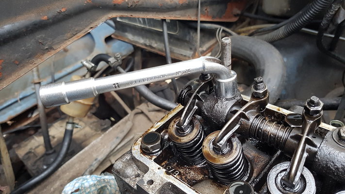

'Special' to me - I bought a set of these Facom spanners (Clés à pipe) when I was working in France 40 years ago. They were expensive, but have paid for themselves many times over since then. All the illustrations in French manuals feature them; they're great for getting into tight spaces. Highly recommended!
