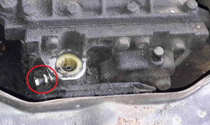

Have you undone the bolt and locking nut that hold the cable?
Hi!
There is a small locking nut on the bolt. See number 17 & 18 on the parts drawing below. Once you removed the bolt you should pull out the cable easily. Maybe due to time and age it could be a little stuck in place?

wiggle. grunt. heave ho, jam. jab. scratch push .. speedo glory - for 2 whole days. fuel pump has gone hmmm but thanks to you all - speedometer is working great (cable replaced only).
