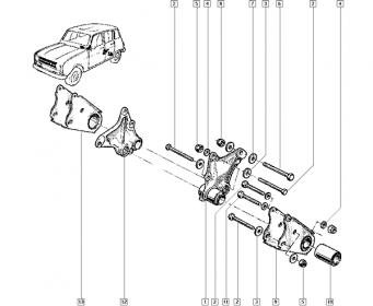

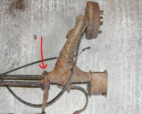

Onto the rear suspension. My manuals are rubbish for later cars (hence this post). Really ought to seek out a factory manual that covers the GTL. Does anyone know what type of bush holds the suspension mounting to the inner mounting (arrowed in the photo)? I have a new outer mounting and I'm tempted to replace the inner mounting while I'm at it (but first more struggling with the torsion bars).
Malcolm, regarding the rear inner mounting, the bush and inner mounting plate are one unit. If you are replacing either the inner or outer mounting they have to be pressed on in exactly the correct position otherwise the body height and suspension will be affected. Trouble is that no Haynes manual gives these measurements or an idea of the jig needed to position these mountings. I would have thought that the official Renault manual would tell you but I have never seen one advertised for the later GTL models. Do you want to replace these mountings because the rubber looks perished?? If so, the perished rubber only goes skin deep so it may be best to leave well alone until you have measurements/details/jig to replace the mountings.
I did actually strip a rear suspension unit and it took lots of heat to remove the torsion bars as they were seized in, but the heat ruined the rubber bushes. I have a feeling that Renault built and designed the rear suspension to last the 'lifetime' of the vehicle!!

Is the section you were talking about ...item number 1 7700627830 £101.46 plus vat....

That's annoying. My main reasons for removing the torsion bars were so the arms would fit in the shotblasting cabinet and to make the suspension small enough to fit on the press so I can press on the new outer bush (the old one is rusty). Orientation of the outer bush isn't critical - it just reduces stress on the rubber.

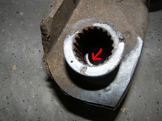

I've had a better look. The early factory manual is helpful - it suggests both the inner bush at the back and the front lower arm bush are obscured by torsion bar splines, and that if you really want to remove them burn the rubber out and try to cut through the outer part of the bush with a hacksaw blade.
I've also found it's difficult to brace the inner rear suspension mounting against anything to knock out the torsion bars while it's off the car. Not bracing sufficiently will tend to disturb that inner bush. I'll wrap the torsion bars with rubber and blast the rear suspension outside.

With the front bushes, try using a rod the same diameter as the inner torsion bar splines. even though it will be bearing on the rubber portion of the bush, the bush can push through, I've had a 60/40 success rate with this method. The 40% that don't work, you have to get out the new hacksaw blade and cut a slot in the outer section of the bush, bend up the edge, then twist and hope the bent bit draws the rest of the section around and out and doesn't just snap off! It is all about time and patience. The two essential items necessary in any old Renault set of special tools!
The inner rear bush is similar to the front, but on the early cars you have to remove the bracket first to get to the outer section of the bush pressed into the arm. And the outer bush section has to be hacksawed (or I guess there may now be a Dremel cutter tool) with a groove in order to lift up an edge and extract the bush portion. If the bush is secure, and doesn't look cracked or perished, I wouldn't bother with replacing it. On my early car I used the Spanish manufacture Neumarsa inner and outer bushes, 12 odd years and 25K miles and they still seem OK.

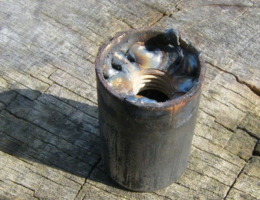

I had a practice on some spare suspension. It's possible to remove the front lower wishbone bush by pressing out the center, cleaning the rubber off, then tack welding a nut inside the outer sleeve and using that to push out the sleeve.

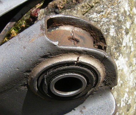

I had been planning to use rough road suspension from my '83 Spanish TL, but look what I found. The upper wishbone bush housing is formed from a tube with a split, and the split is orientated towards the wishbone on the other ones I looked at. This one is orientated away from the wishbone and a crack has started.
Nice! An easy simple solution!

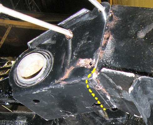

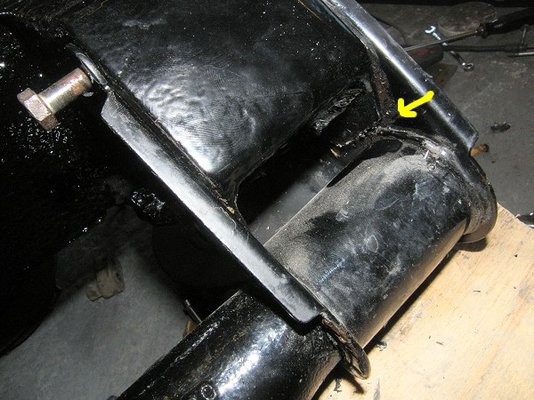

I was very careful to align the outer rear suspension mounts using a steel rule and a square to reference the hub position, and I pressed them in just the right amount (apart from the one I pressed in 2mm too far). Thanks Angel - they did hammer on with a lump hammer and a steel plate to spread the load.
But the rear suspension just wouldn't go on. It's always trickier on a bare chassis as there's no weight to push against, but this seemed worse. I checked all my measurements again and everything seemed fine. Paint removed, copper grease applied for lubrication, and finally after several hours the suspension was mounted on the car. And then I found the problem.
The replacement outer mountings are '60s style and my chassis repair is '80s style. '80s style rear outer mounts have a cutout (yellow line in the photo) to allow the mounting to twist to the limit of the adjustment slots. After all that the rear suspension will need to come off the car again for modification. :shock:

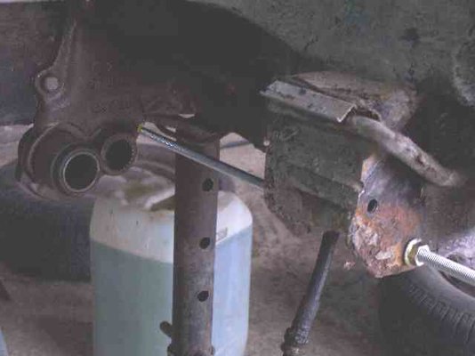

Try us they do. Dropped the rear suspension to modify the outer mounts, and that did make it easier to fit the second time. But guess what - the weld on the outer mount fouled the sides of the chassis member. They were only 1mm too long but it meant dropping the suspension once again.
Finally it's on - third time lucky!

Just remembered something else.While the factory manual gives measurements for correct alignment for both the inner and outer mountings on early cars, there are no measurements for post '77 cars with the cast inner mountings (and the method described for the earlier pressed steel mounting cannot be utilized).
So my solution was the following: I bolted the new inner mounting on its position on the chassis, then passed an M8 rod through one of the outer mounting holes, and tightened it. Then I marked the position where it met the inner mounting.
I pressed the new outer mounting on the arm first, and by screwing the rod on the same mounting hole as used on the chassis, and aligning it with the paint mark, I was able to determine the correct inner mounting position in relationship to the outer.
The holes aligned perfectly when putting the assembled arm back.
