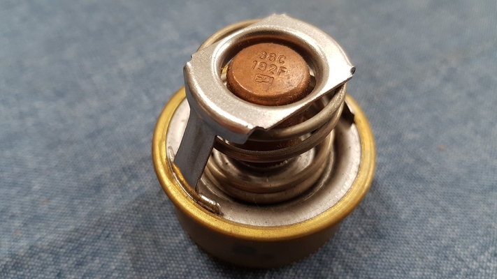

I can help with an 88 degree thermostat if you have the type in the photo:
76 degrees will be too low for your climate, better fit an 86 deg. one.
