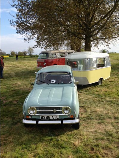

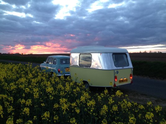

Look in the back of your manual. The towing weights are set out, I tow an Erin's Puck caravan . It does the job very well though is on the limit with all my sandwiches and beer inside !

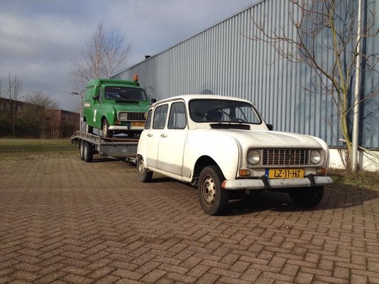

We made this photo as a tribute to Christophe Goujon. Never drove a meter with this combination.

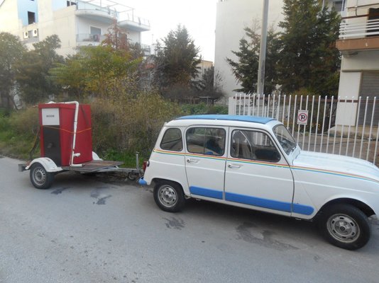

It doesn't look big, but it's very heavy. It's a central heating burner that should weigh over 500 kilograms, plus the weight of the trailer. I towed it for a distance of some 30 kilometers. No issues at all, even with the Jogging's tall gearing. The trailer had no brakes, I was cautious and braked in anticipation, but I didn't notice any fading or other problem.
