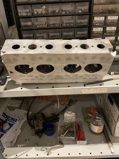

I checked the ports on intake and exhaust and there are a lot of things you can do to reduce turbulence and get more laminar flow
You may improve flow in the ports, but valves are small and rather shrouded by the combustion chamber. And the fact that there are no individual inlet ports limits carburettor choices.

The intake port look really bad so I will reshape some areas. Will fill long radie with JB-weld and reshape (area expands for no reason under valve seat to disturb flow) otherwise mostly a clean up. Everything for improved gas flow. Not bigger but smoother and flow friendlier is the concept.
I will add three more pinstuds for the intake and exhaust manifolds to assure exhausts stay in the pipes.
As long as I stay with 58mm bore valve curtain are is catastrophic but have to live with it.

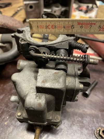

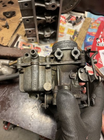

Checked intake side today and carb is Solex 30/35 PDSI(T) with 35 mm trottle.
Maybe reason why I felt bit stronger than what it’s supposed to.

Carburettor is probably a VW Typ 3 part, they were fitted in pairs on the flat four engine.

Carburettor is a generic Opel carb. They use Solex30/35 PDSI(T) on 1.1-1.7 litre engines under long period. I guess 1.1 litre version can be quite good start setup for small Renault engine.
Not sure how common Opel is in your countries, guess GB mostly had Vauxhall. In Sweden Opel propably was top five selling brand in the 70-ties.
I recall the 35PDSIT on the Kadett D had a large torsion spring for throttle return, yours may be from a RWD Opel.
