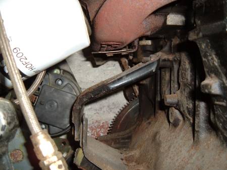

Well.. i had a go at removing the starter today, with no luck :(.The starter is loose (was held by two bolts only third hole had no bolt), unfastened the steering shaft and put it to the side. Unfastened the bolt that connects the engine mount stabilizer to the engine mount and was hoping that the clutch cable top support would come loose, and it didn't. I have no idea what kind of bolt/nut is holding that stabilizer to the block, i can't see it as it's under the exhaust manifold. Then i ran out of light. I guess i'll have to release the clutch cable completely before i can remove the whole stuff from the way. Besides this releasing the starter wasn't that hard. Oh well under the car i go to release the clutch cable... Bah!
Looks like a 13mm nut holding the bracket to the block. I've attached a photo of an engine in the corner of the garage.
I tend to undo the clutch cable from the lever on the block before taking the bracket off. It's easy to do if you use a crowbar to pull the lever upwards a little. I think there is a second nut holding the clutch stabiliser bracket to the engine mount - it goes from front to rear.
Once you've pulled the bracket off you'll need to move the starter towards the rear of the car, twist a bit, angle it upwards and outwards, and it'll come out of the hole with so much clearance that you'll be wondering why it was being so troublesome before. It's a bit like one of those Chinese puzzles.
