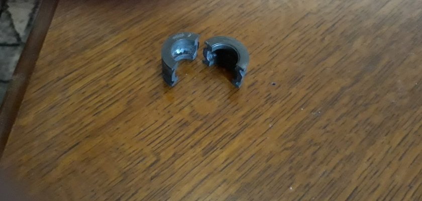

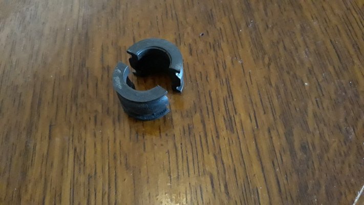

A few years ago I had a car accident that caused damage to the corner of my R4. Then he fell off part that I have no idea what it is.
I'm hoping someone will know what the part are.. Any help is appreciated..
Here are the pics:
It looks like the bush between steering column and its rubber boot where it passes through the bulkhead. It's not damaged, it's in two pieces.
It is just what Angel said. Plastic bush on steering column in rubber buth on bulkhead. It is made of two peaces.

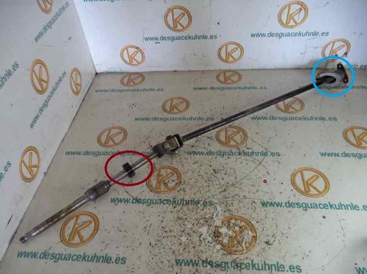

That circled is not what is on your pictures.
Circled is sliding bearing that is in steering column housing.
Bush we are talking about is made of plastic and it is located in that rubber booth up right on your picture.
I have circled it in blue.

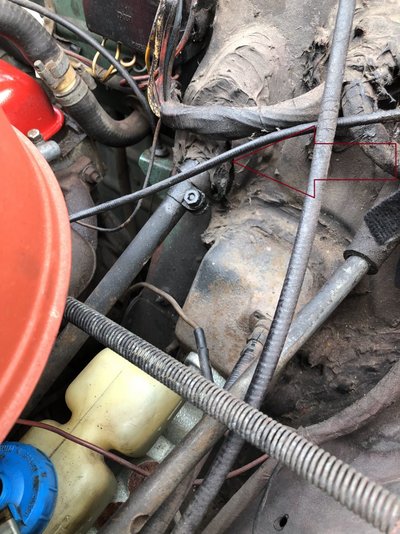

that looks a mess the clamp there is not standard the 2 plastic pieces you found should sit inside the rubber gromet and provide a noise and smell insulation barrier
