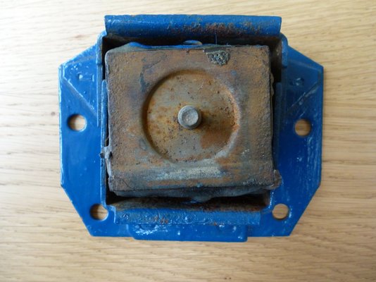

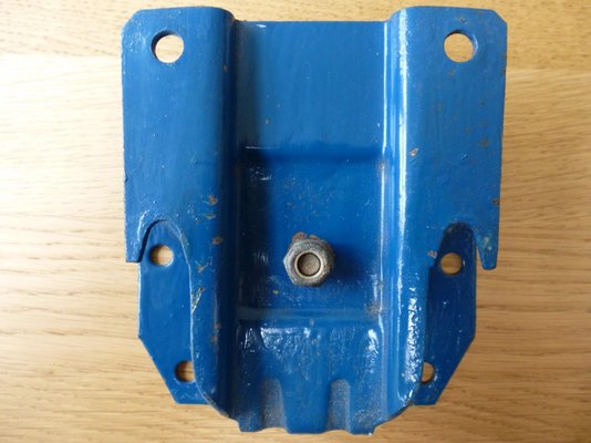

These pictures might help.
This one is the part you need to buy:
This one is the part you need to transfer from the broken part to the new one:P1000336.JPG
And this is how they look together (note that in the picture the nut is only loosely attached):P1000337.JPG
Removing and replacing the mounting is straightforward, but you'll need to support the gearbox with (for example) a jack. If you're not confident you can do it yourself, a garage will do the job in a very short time.
This one is the part you need to transfer from the broken part to the new one:View attachment 14069
And this is how they look together (note that in the picture the nut is only loosely attached):View attachment 14070
