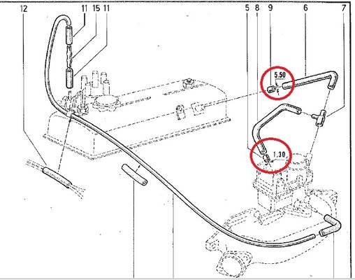

Hi Jeff
Does this help?

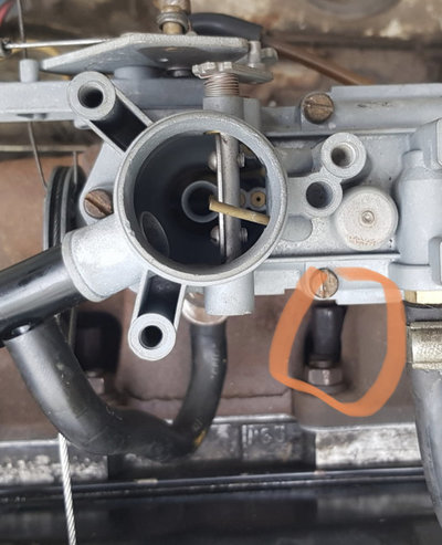

What’s the hose I circled in orange highlight?
Yes. This helps greatly! Thank you.
Thanks for the reply. You are right. I see what you mean.

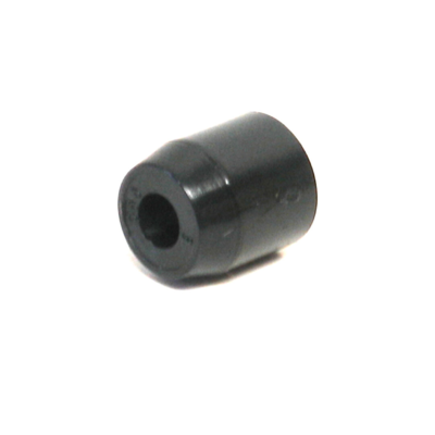

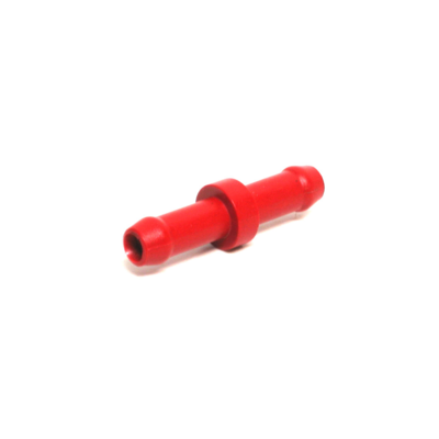

Don't forget the restrictors. Sizes are in millimeters so 1,3mm for the lower and 5,5mm in diameter for the upper hose.
